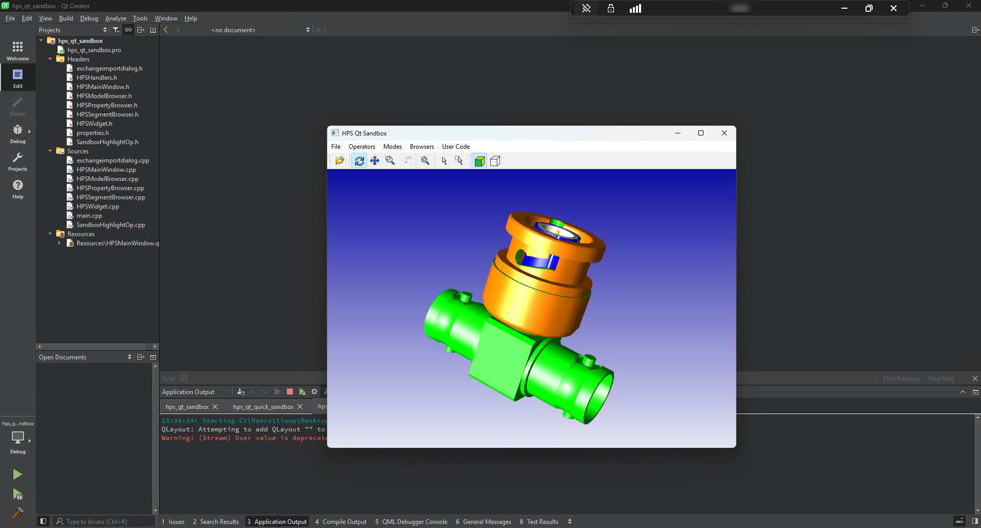

Hello @michael,
You should be able to just load the hps_qt_sandbox.pro file found in HOOPS_Visualize_2025.8.0\samples\qt_sandbox in Qt Creator, choose the kit to be used for the project, build and run. As a quick test, this is what I get:
Can you provide more information on your build?
Thanks,
Tino
