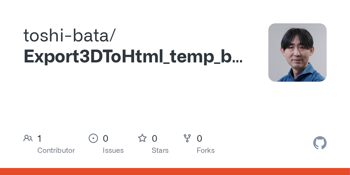

I’d like to share an enhanced version of the Export3DToHtml sample that extends the capabilities of the standard example provided with the HOOPS Publish SDK. This project aims to offer a more flexible and customizable base for generating standalone, monolithic HTML 3D viewers.
GitHub Repository:
What’s New?
This sample builds upon the original by introducing:
  • Toggle controls for UI components: model tree, toolbar, axis triad, and navigation cube
  • Injection points for custom JavaScript, UI elements, and CSS styles

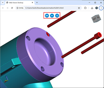

Side-by-side comparison:
Original Sample Enhanced Version
Sample HTML viewer Modular, toggleable UI and custom extensibility
Static layout Fragments-based HTML template assembly
Sample HTML viewer
Enhanced Version
Template Architecture
At the core is a new HtmlTemplateBuilder class, which assembles the monolithic HTML by combining fragment files located in the template/ folder. These are modular pieces of the HTML (scripts, styles, UI blocks), and users can selectively enable features using bitwise option flags (e.g., 0011111).
Each bit controls a specific UI module or extension point—such as custom JavaScript callbacks that run before the viewer initializes.
Example: 0011111 disables standard UI except the Axis Triad and Nav Cube but injects custom styles, scripts, and body UI.

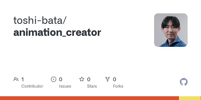

A key target for this project is exporting animated content built with the Animation Creator. With this enhanced sample, the animation logic can be embedded directly into a distributable HTML file—perfect for sharing:
  • Assembly or maintenance procedures
  • Simulation sequences
  • Dynamic product presentations
Live Demo (Animation Creator Export Example):
This live demo showcases how animation results can be exported and viewed in a standalone, interactive monolithic HTML file using the enhanced Export3DToHtml pipeline.
GitHub Repository:
