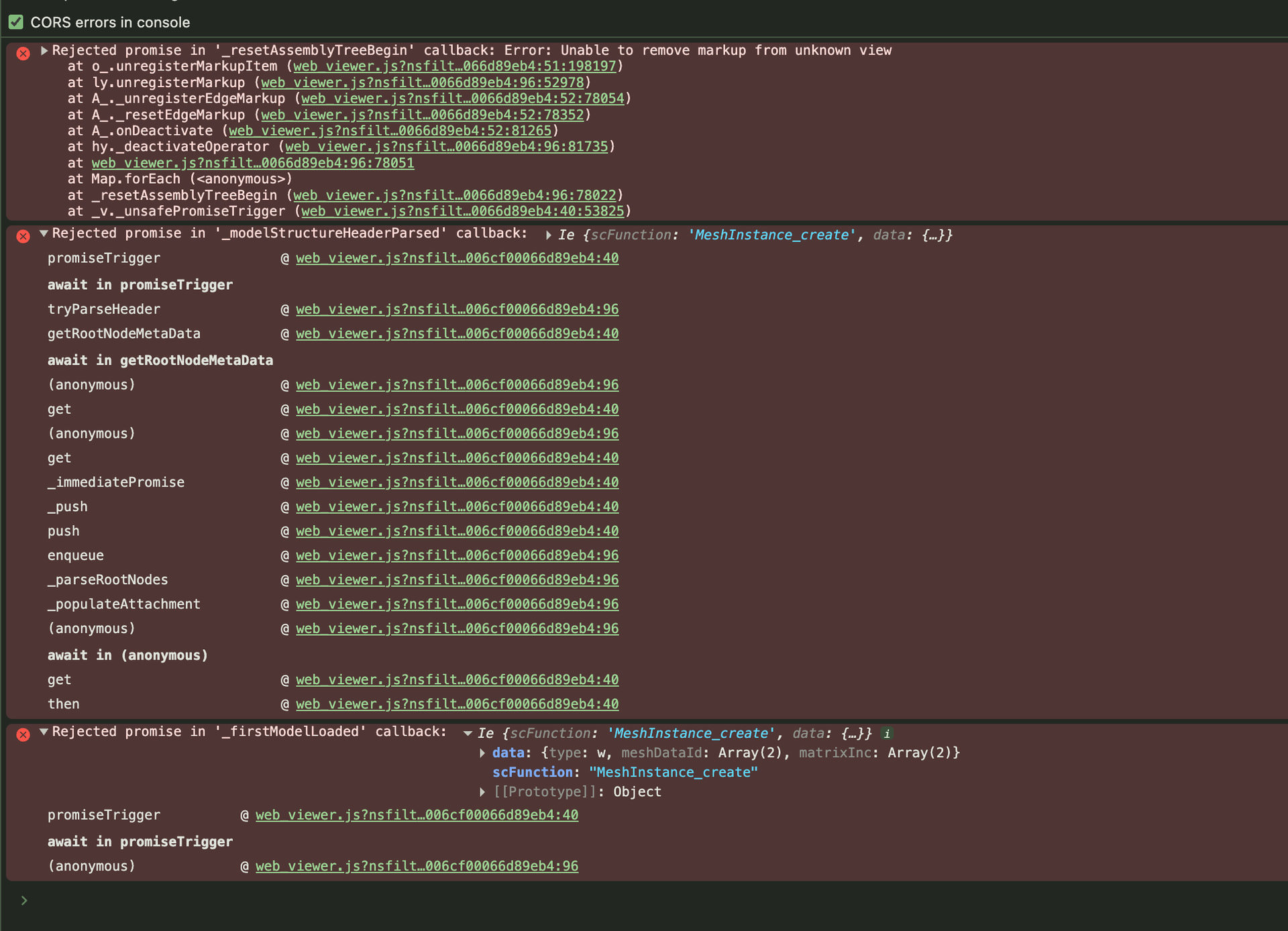

I’m seeing a couple of rejected promise errors when switching between 2D sheets in HOOPS Visualize Web 2025.6.
Code
await viewer2d.model.clear();
await iafViewer._viewer2d.model.loadSubtreeFromModel(
    iafViewer._viewer2d.model.getAbsoluteRootNode(),
    fileName,
    subtreeConfig
The clear() call is awaited before calling loadSubtreeFromModel().
Errors observed
The browser console reports the following:
  1. During model.clear():
Rejected promise in '_resetAssemblyTreeBegin' callback:
Error: Unable to remove markup from unknown view
Stack trace includes:
unregisterMarkupItem
unregisterMarkup
_resetEdgeMarkup
onDeactivate
_deactivateOperator
  1. During the subsequent load:
Rejected promise in '_modelStructureHeaderParsed' callback:
MeshInstance_create
and
Rejected promise in '_firstModelLoaded' callback:
MeshInstance_create
Additional information
  • HOOPS Visualize Web 2025.6
  • This occurs while switching between 2D sheets.
  • model.clear() is awaited before calling loadSubtreeFromModel().
  • No parallel loadSubtreeFromModel() calls are made.
  • The sheet still appears to load correctly, but these rejected promises are logged in the console.
