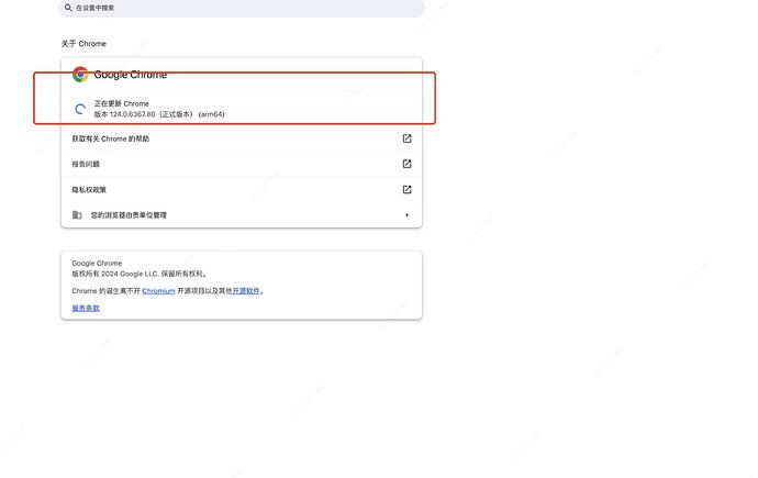

HoopsCommunicator can't render any models after upgrading Google Chrome to version 124 on mac systems
I tried the latest version of HOOPS Communicator 2024.2 and still have this problem, only chrome and edge on mac systems have the problem of not rendering!
Older versions of chrome still work fine, but the chrome on the client’s computers are automatically upgraded
