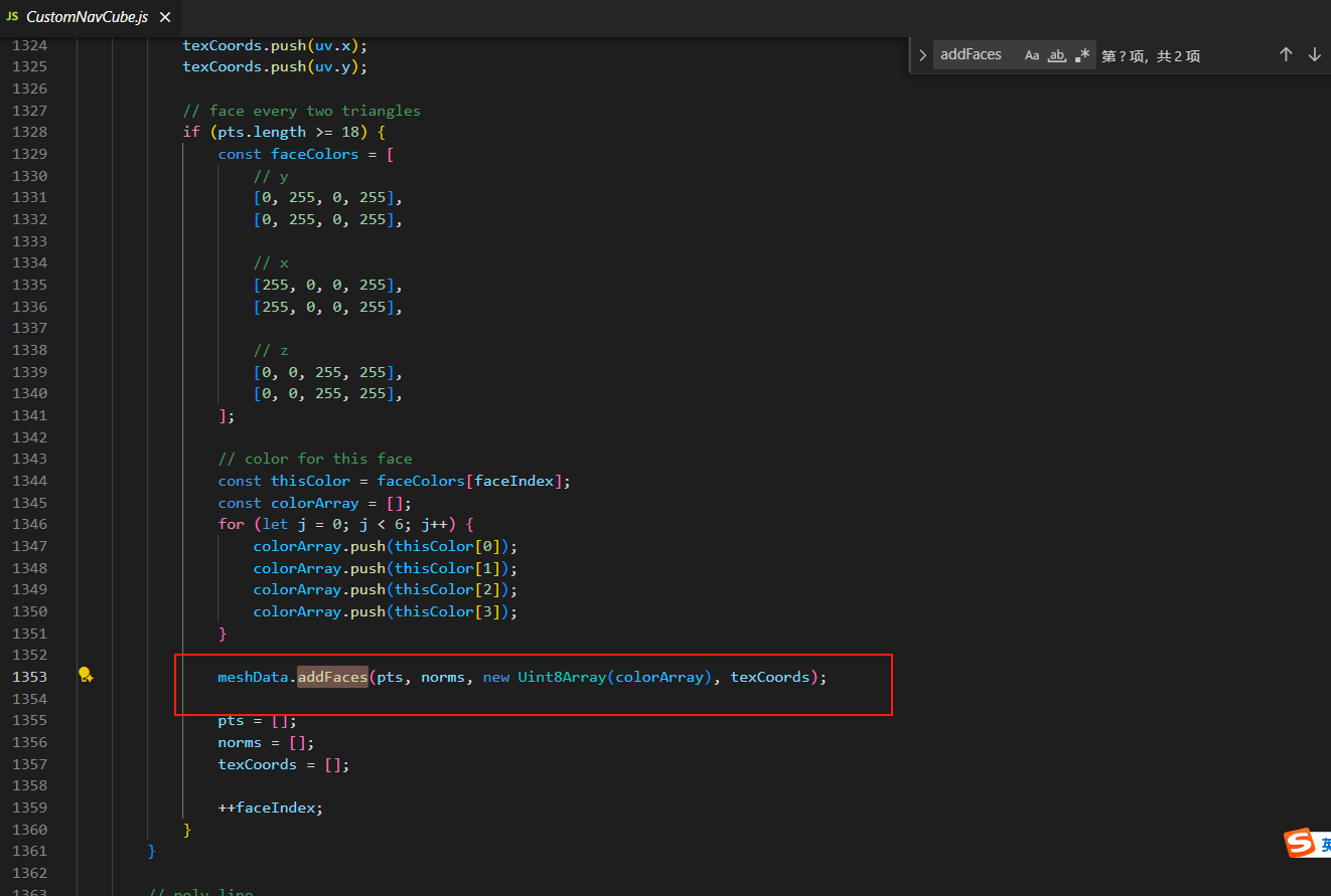

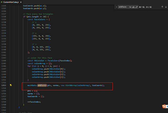

However, during the usage process, an error occurred, indicating “Uncaught (in promise) TypeError: meshData.addFaces is not a function” at CustomNavCube._createCube (CustomNavCube.js:1353:26)
at CustomNavCube._createGeometry (CustomNavCube.js:388:28)
at CustomNavCube.init (CustomNavCube.js:213:20)
at async modelStructureReady
This is the way I refer to JavaScript. JavaScript is at the same level as HTML.
The code I used is the original CustomNavCube.js concept verification code that was released here initially. I did not make any modifications to it.
Then the version I used was hoops communicator 2024.5.0

Then I printed out the data type of meshdata as follows. It seems that there is no “addFaces” option.
I don’t think it is the Communicator version that is the issue. Also, the meshData object, per your screenshot, in the dev console won’t show the member function for the class so this is expected.
